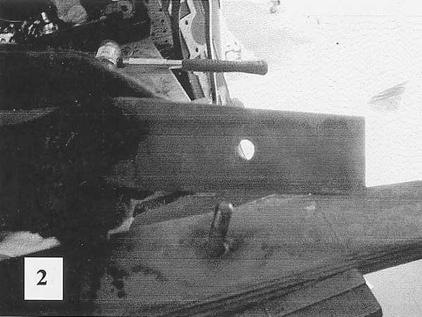

Step 2: continue by removing the support leaf (it's the smallest one, located at the bottom).

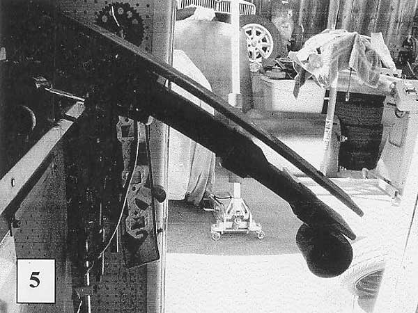

Step 3: cut the largest leaf, as seen in picture. From the center hole
to the cut end should be the same as the removed "support leaf".

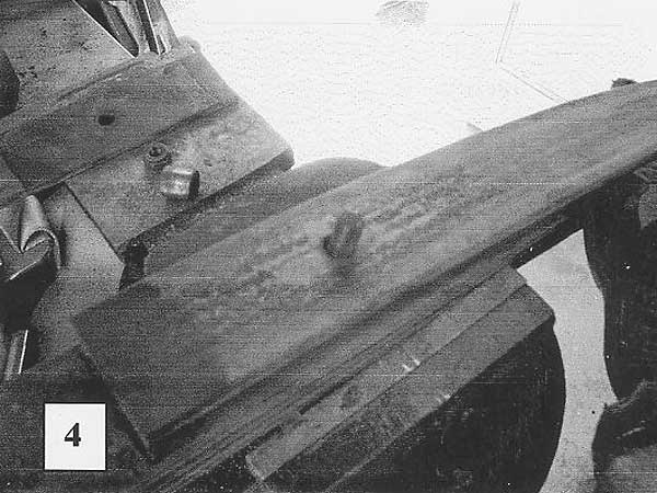

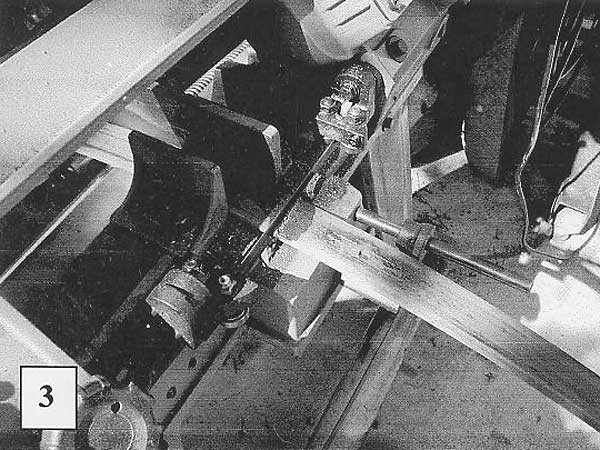

Step 4: unfasten the u-bolts on your MGB and (leaving the clamps alone)
remove the center bolt. Then, reinstall the center bolt with the modified
large leaf added below the spring pack. (Your leaf springs don't actually
need to be fully removed from the car, as shown here.)
Step 5: tighten the center bolt to specs. Then, follow the shop manual processes
to make sure your leaf springs are reinstalled and tightened-up correctly.

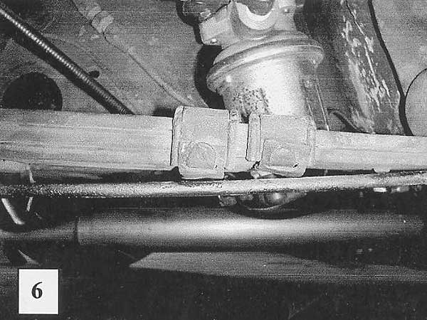

Final: it should look like this when mounted on the car and on the ground.
(The extra leaf only engages to counter-act & minimize wind-up at launch!)
