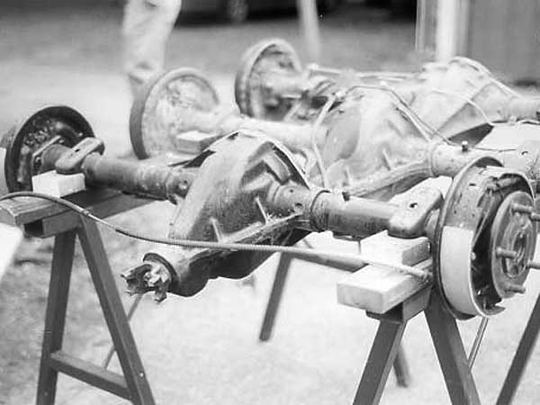

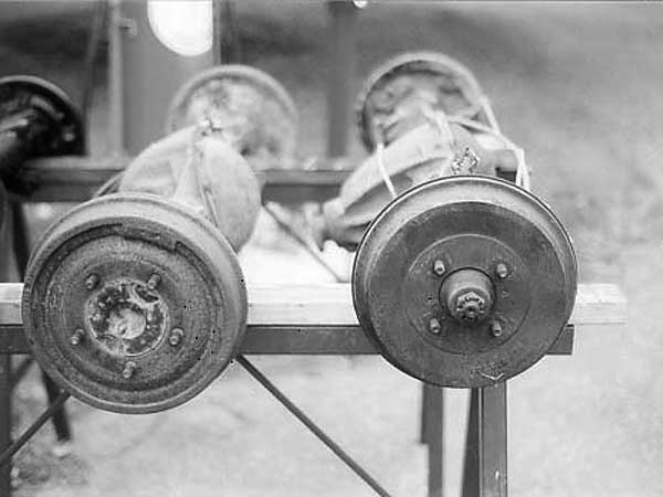

Over the last several years, several Newsletter contributors have mentioned that the rear end from under a Post Office Jeep Dispatcher may be a prime candidate for use under an MG V-8 conversion. Dan LaGrou decided to follow up on these rumors and obtained two of the Jeep rear ends which were on display for examination at his D&D Fabrications Customer Appreciate Day last August. It appears that certain of the Post Office carrier Jeeps have Dana 44 rear ends under them. The other Jeeps had American Motors rear ends which do not enjoy a good reputation. The desirable Dana unit can easily be identified by the flat area on the axle ends, between the lug nuts. The AMC unit has a threaded spline axle ends with a large nut and cotter pin, just like an MGB.
Dana (L) and stock MGB (R). Note that the Dana axle end is flat between the lug nuts. The undesirable AMC version of the Jeep rear end has a protruding nut at the axle end, just like an MGB, making identification easy.
Jeep Dispatcher Dana 44 rear ends (two in front) and MGB (rear) Simple spring mounts on Dana are easily replaced with salvaged or new MGB mounts.

Both of the Dana 44 rear ends on display carried a number C35284 cast into the differential housing. While measurements were being taken, several rear ends were attached to a scale and a forklift and individually weighed. The stock MGB (drum brake version) weighed 170#, a Ford 9" diff weighed 179# and the Dana 44 was the heavyweight at 190#. The axle mounts on the Jeep rear ends were simple and easily removed. MG mounts, either new or salvaged from an MG rear end, could then be welded to the Dana axle tubes. (Remember to check the pinion angle!)
