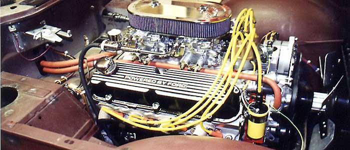

Dual-Carb 302 Ford being trial-fit in a Triumph TR6 (owner: Dan Masters)

SMALL BLOCK FORD
The dark horse of swappable engines, the Ford 302 has only lately come into its own. Since the introduction of the Fox bodied Mustang 5.0 in the mid eighties, the popularity of the Ford small block has grown by leaps and bounds, along with the availability of aftermarket parts.PROS:
a) Weight. At 519 pounds stock, and 424 pounds in fighting trim, the Ford engine falls between the BOP/R and the Chevy. Still quite heavy as a replacement for four cylinder engines, it is actually lighter than the stock TR6 or Austin-Healey engines. Dramatically lighter than the MGC engine!
b) Size. It is the smallest domestic V8 on the market. The width of the Ford can be a real lifesaver in many small car installations.
c) Displacement. Even though less than the most Chevy small blocks, 302cid is still a big improvement over stock British engines. Stroker engines are obtainable up to 347cid at a relatively low cost.
CONS:
a) Weight. Even at a reasonable 424 pounds, the weight can be too much for some of the smaller sports cars. Aftermarket aluminum heads aren't inexpensive.
b) Front mounted oil pump and distributor. In some cases, this can be a real problem, as it takes a lot of room in front of the engine to accommodate these items.
c) Oil sump clearance problems. Because the oil pick-up is located in the front, the oil pan sump is also located in front, where it can cause interference with the crossmember in many cars. Dual sump pans are available, but even with these, the front sump is still deep enough to interfere in many installations.
