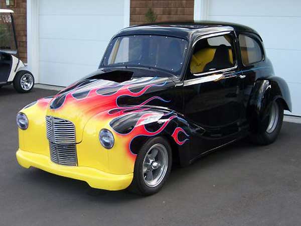

1948 Austin A40 Dorset - Mopar Big Block Pro Street Drag Racer
1948 Austin A40 Dorset - Mopar Big Block Pro-Street Drag Racer
City: West Linn, OR
Model: 1948 Austin A40 Dorset

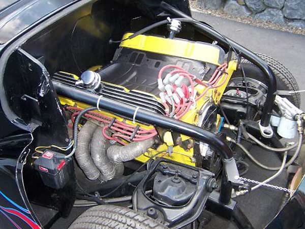

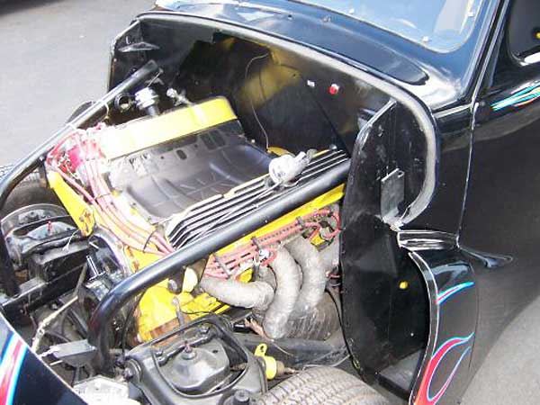

Engine: Mopar big block (520cid) V8
Conversion performed by: Owner.
Engine: 520 cubic inch big block Mopar with 904 cast heads that have been professionally ported and polished with oversize valves. Aries 12.5 to 1 pistons, Crane roller cam (gear driven), Indy oil pump with 8 quart oil pan, Crane gold roller rockers, and aluminum valve covers.
Exhaust: custom made headers.

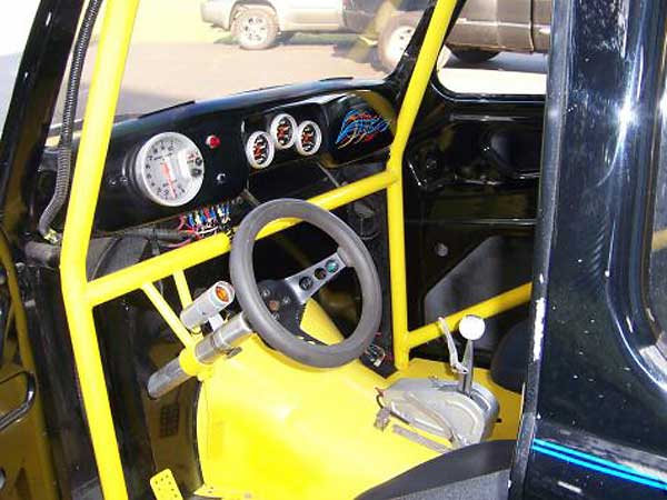

Transmission: 727 Torqflite professionally built with Art Carr parts, transbrake and reverse valve body. B&M pro stick shifter. The torque converter is a TCI with a 4500 RPM stall speed.

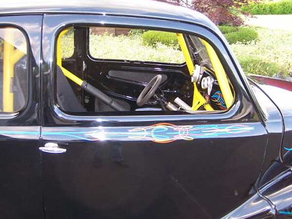

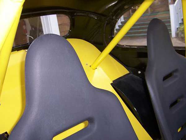

Chassis: custom mild steel tube chassis with full roll cage, NHRA certified in 1999.
Front End: Ford Mustang II, with disc brakes.

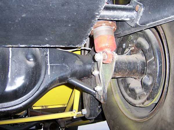

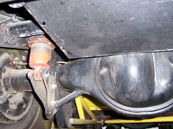

Rear Axle: 9 inch Ford, narrowed and mounted in a custom 3-link suspension with ladder bars. 4.56:1 gears, with a spool and 33-spline Summer's Brothers axle shafts. Drum brakes.
Wheels: American Torq Thrust (front) and custom 10 inch wide steel wheels (rear).

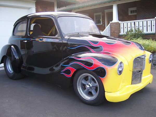

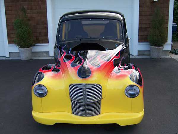

Body: all steel - no fiberglass! - two door, with the front end bolted together and made into a tilt front end. All window glass (except the door windows) has been replaced with Lexan. The hood has been cut for either an Enderle injection system or an Enderle injector-type scoop.

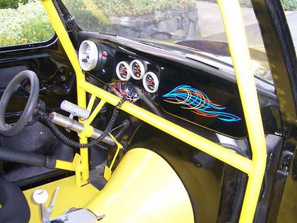

Electrical: The tach, shift light and gauges are all by Autometer. The switch panel is a Painless, mounted on the roll cage above the windshield.
Other: 12 gallon JAZ fuel cell.
custom headers for big block mopar
exhaust wrap
autometer gauges, B&M shifter
Painless wiring kit
full roll cage
Pro Street racing seats

Ford 9 inch rear end
3-link rear suspension with Panhard bar and ladder bars
hood cut for Enderle injector scoop
tilt front Austin 2-door
