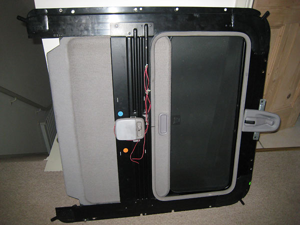

1994 Nissan Micra sunroof, ready to transplant.
Audis, BMWs, Rovers were all the correct width but much too deep. Some Japanese sports cars had strange roofs that opened outwards. And then there was a 1994 Nissan Micra. It was an exact match for the GT roof shape. I decided its 32" by 15.5" opening would fit nicely!
It took less than hour using only a hammer and tile chisel to cut the Micra roof off at its pillars, put it in the back of my car and pay. At £25 it was a good deal.

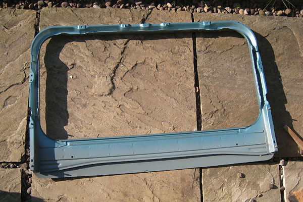

Back home, I unbolted the mechanism from the roof.
I used an electric jigsaw to carefully remove excess Nissan roof sheetmetal.

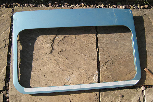

I kept 1" of metal along each side edge and 1.5" along the front.
At the rear, my cut line measured 5.25 back from the stamped opening.
At the rear, my cut line measured 5.25" back from the stamped opening
because I decided to retain a strengthening brace.

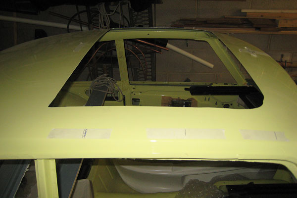

MGB GT roof, cut to accept the new sunroof.

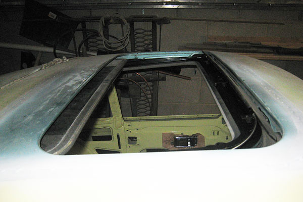

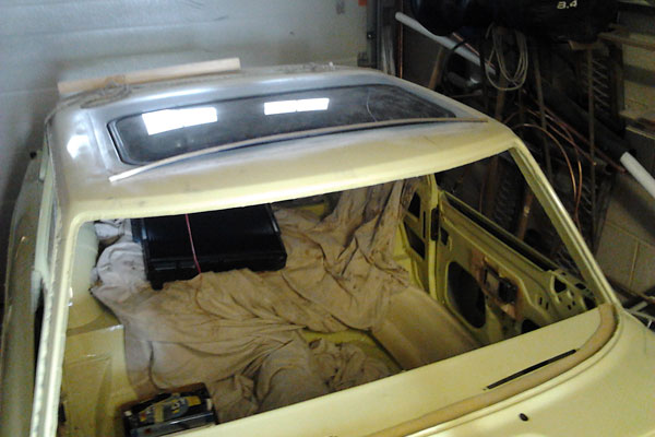

Nissan Micra sunroof frame, welded into place.

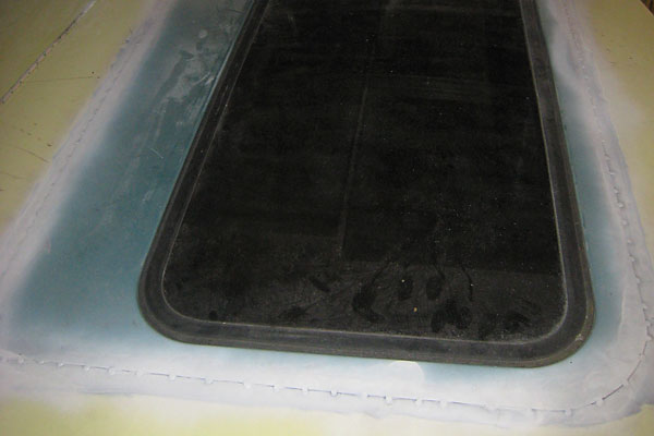

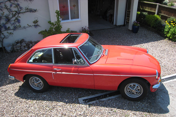

The sunroof has been mounted, and proper operation has been verified.

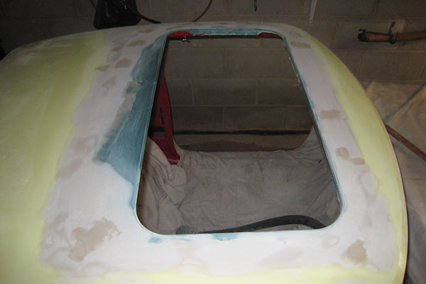

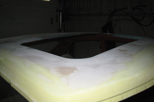

Body filler has been applied and leveled out.
