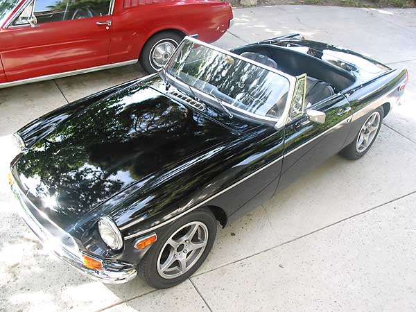

Edd Weninger's 1977 MGB V8 Conversion (1980 Rover SD1 3.5L)
Owner: Edd Weninger
City: Huntington Beach, CA
Model: 1977 shell, lowered and converted to chrome bumper with 1972 bits
Engine: 1980 Rover SD1 3.5 Liter
Conversion performed by: Phil Dooley, Phoenix AZ

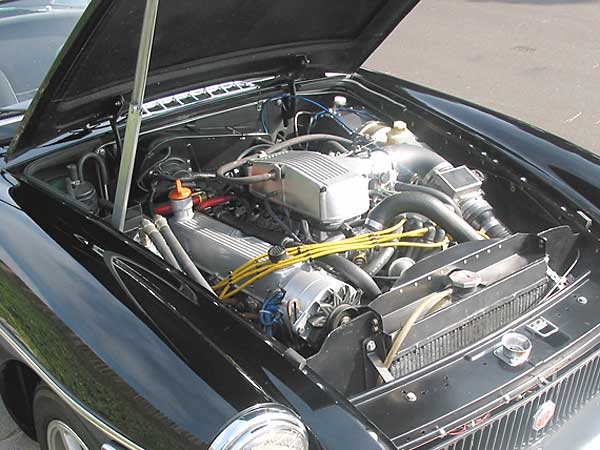

Engine Mods: .030 over-bore, Keith Black Silv-O-Lite pistons, 9.2 CR, Sealed Power moly rings, Crower cam (mild), Edelbrock double-roller timing chain, Melling push-rods, Arp stud kit, Felpro gaskets.
Intake: 1989 Rover Hot-Wire EFI, machined to fit under stock hood (bonnet), -14CUX ECU with switchable tune resistors, Bosch flowed and matched injectors, Bosch fuel pump and filters, K&N air filter located in front of radiator
Ignition: Buick distributor (points).
Cooling: Four-row custom radiator (4" taller than standard MGB).
Exhaust: Blockhugger headers with ceramic coating.
Transmission: Rover LT77 5-speed.
Suspension: Chrome bumper cross-member, V8 suspension bushings, brake pads and shoes.
Wheels/Tires: 5 spoke silver alloys 15x6, Yokohama Avid 195/60-15s.

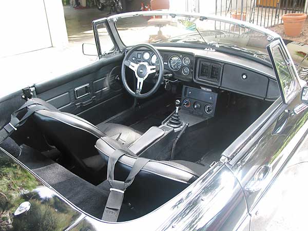

Interior: Beard seats, Crow Enterprises 4-point belts, Mountney leather steering wheel.
Completed: I've enjoyed it since January 2003.
Rover hot-wire EFI looks right at home under Edd's standard MGB hood
Beard seats, Crow belts, and Mountney leather steering wheel
