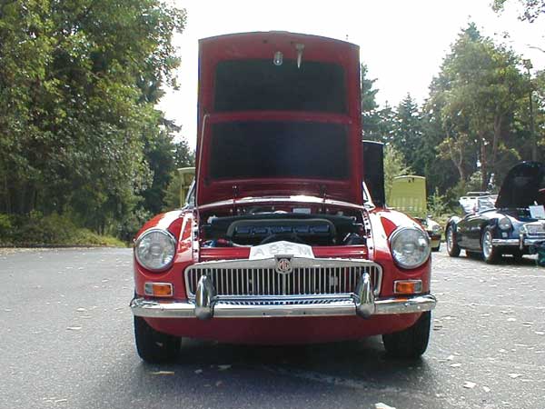

Remy Cano's 1965 MGB with Buick 225cid V6
Remy Cano's 1965 MGB with Buick 252cid (4.1L) V6
Larry Embrey wrote: "This was the car's 1st show, and it was gorgeous. Rem spent a lot of time custom fitting the Buick V6 into the car and doing finish work that really make the car a complete package."

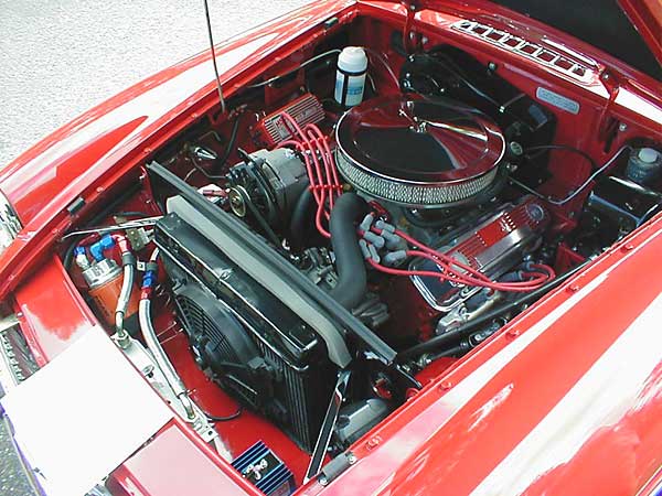

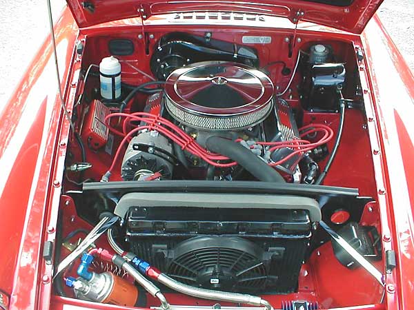

9) Rem has installed the engine in a "Mark 1" MGB, which has a characteristically small tranny tunnel.
10) Rem has adapted the Buick cable-operated clutch in lieu of hydraulic clutch actuation.
11) It was apparently necessary to relocate the parking brake lever to make room for the driveshaft.
12) With a "drop base" air cleaner and a low-rise aftermarket aluminum (apparently Offenhauser) intake manifold,
      Rem has managed to keep the stock MGB hood unmodified! The radiator is also in its standard location.
Steering has been modified (with additional u-joint) and a cable-operated clutch has been fitted.

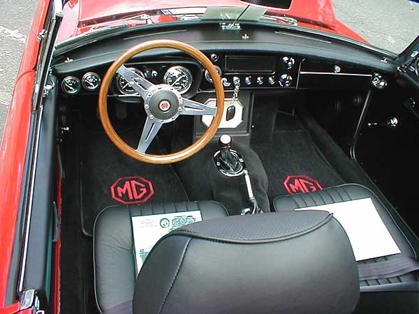

dashboard has been painted gloss black, and additional gauges have been installed
The dashboard has been painted gloss black, and additional gauges have been installed on the left side.
Note the removeable-face radio, and that speakers have been mounted in the footwell area.
The parking brake lever has been moved to the top of the driveshaft tunnel.
MGOC / Moss aftermarket seats that are custom designed for MGB.
MGOC / Moss aftermarket seats that are custom designed for MGB. Note bulkhead-mounted speakers.

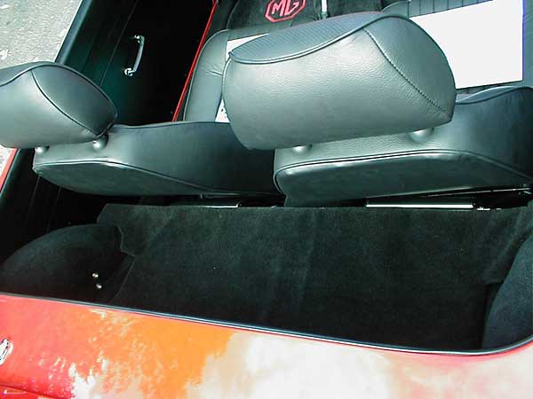

Audio system amplifiers are hidden behind the seats.

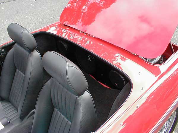

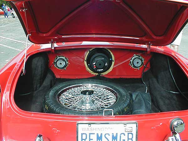

A subwoofer is mounted in between two smaller speakers in the rear bulkhead.
