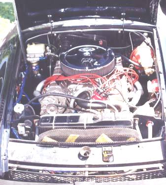

BILL YOBI, Canfield, OH
1979 MGB
ENGINE:   1962 Olds 215
MODIFICATIONS:   TRW 10.4:1 forged pistons, larger valves/ported head, Isky 272 cam, balanced, Carter 500cfm (stock manifold), MSD 6AL ignition, baffled oil pan, oil cooler w/ thermostat
COOLING:   B-cool aluminum radiator, Spal fan, coolflex hoses
TRANSMISSION:   Rover 5-speed
BELLHOUSING/CLUTCH:   Rover, lightened flywheel
REAR END:   stock MGB
BRAKES - FRONT:   stock MGB, Mintex pads
BRAKES - REAR:   stock
SUSPENSION - FRONT:   1" lower springs, Delron bushes, Spax shocks, 7/8" sway bar, negative-camber A-arms
SUSPENSION - REAR:   lowering blocks, Delron bushes, Spax shocks, factory sway bar
WHEELS/TIRES:   15 X 5.5 Minilite replicas (knock-offs), Bridgestone RE71 195/60
EXHAUST:   stainless block hugger headers, custom dual Turbo Flow mufflers, Monza resonator tips
INSTRUMENTS:   stock and VDO
SPECIAL FEATURES:   paint (candy apple red metallic), Fiero leather seats w/ speakers, back seat for kids, functional hood scoop, gas struts hood and trunk
    Bill Yobi's '79 MGB with Oldsmobile 215 V8

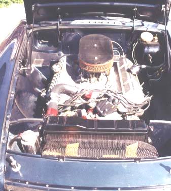

BERNIE POSEY, Elyria, OH
1979 MGB
ENGINE:   3.9L Rover
MODIFICATIONS:   Crower cam, Edelbrock intake manifold, Carter 500
COOLING:   MGB rad w/tanks reversed, 4-row extended Super-Cool core
REAR END:   Ford 8", 3.0:1 gears
BRAKES - FRONT:   stock MGB, fresh
BRAKES - REAR:   stock MGB, fresh
SUSPENSION - FRONT:   stock MGB
SUSPENSION - REAR:   stock MGB
WHEELS/TIRES:   Minilites w/Michelin SR185-14
EXHAUST:   2 1/2" single exhaust, Walker Dynomax
INSTRUMENTS:   stock MGB (modified tach)
SPECIAL FEATURES:   Fiero seats (Mr. Mike's leather), speakers in headrest
    Bernie Posey's '79 MGB with Rover 3.9L V8

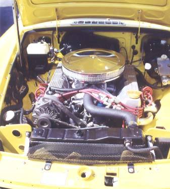

DALE SPOONER, Williston, VT
1977 MGB
ENGINE:   Ford 302ci V8
MODIFICATIONS:   9.6:1 compression, ported aluminum heads, Edelbrock carb & intake, balanced, 315 HP @ 5,200rpm, 335 lbft torque @ 4,400rpm
COOLING:   Griffith aluminum radiator, Moroso pump
TRANSMISSION:   C-4 automatic
BELLHOUSING/CLUTCH:   N/A
REAR END:   8" Ford (2.79:1) center with MGB ends
SUSPENSION - FRONT:   gas shocks, uprated springs
SUSPENSION - REAR:   gas shocks
WHEELS/TIRES:   Minilite replicas
EXHAUST:   home-made ceramic coated headers, 2" dual stainless pipes
INSTRUMENTS:   Autometer tach & speedo
SPECIAL FEATURES:
    Dale Spooner's '77 MGB with Ford 302 V8

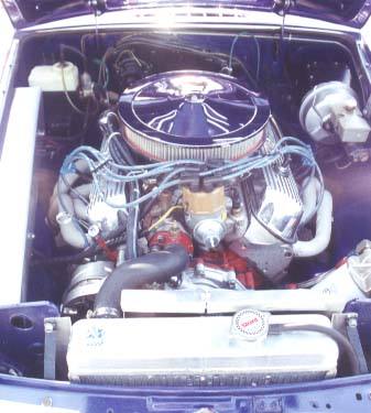

KURT SCHLEY, Rocky River, Ohio
1974 MGB
MODIFICATIONS:   dual Rochester 2bbl 2GC carbs (0.052 jets), Offenhouser manifold, Crower 287 cam, hi-perf lifters/springs, Olds high-comp heads, double roller timing chain, Buick "metric" oil pump, MSD 6 AL ignition, Edelbrock valve covers, Delco 40A alternator
COOLING:   stock 1977 MGB radiator, (high cooling point is in top hose,) mechanical fan (with cut-down blades) + stock 1977 MGB electric fans, vented inner fenders
TRANSMISSION:   T5 5-speed from V8 Trans-Am (0.73:1)
BELLHOUSING/CLUTCH:   Buick/Olds 215 4-speed bellhousing, 10.4" Camaro clutch, TR8 flywheel, 10" pressure plate, Weber hydraulic throw-out bearing
REAR END:   stock 3.9:1 MGB (2500 rpm @ 70 mph/5th gear)
BRAKES - FRONT:   stock with TR8 pads
SUSPENSION - FRONT:   Monroe tube shocks, V8 bushings, 7/8" Adco sway bar in urethane bushings
SUSPENSION - REAR:   Corvette air shocks, traction bars, Panhard rod
WHEELS/TIRES:   Prime 225/50 Continentals
EXHAUST:   Buick 300 manifolds, custom smoothbore stainless flexible hose w/ two wraps of heat resistant Kevlar cloth, then stainless braid, twin turbo mufflers
INSTRUMENTS:   stock
SPECIAL FEATURES:   trunk-mtd battery, roll bar, oil filter behind passenger headlight, custom stainless overflow tank
    Kurt Schley's '74 MGB with Oldsmobile 215 V8

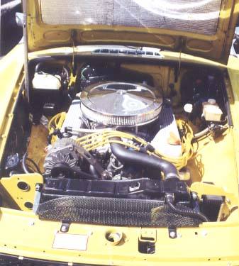

MIKE ENGLETON, Munster, IN
1979 MGB
MODIFICATIONS:   total rebuild, machined to 0.030" overbore, 10/10 crankshaft, stock cam, rebuilt heads, new rocker shafts, valves, springs, retainers, etc, 10.24:1 compression
COOLING:   stock radiator with enlarged core, inlet and outlet
TRANSMISSION:   BW T5 5-speed with 0.63:1 fifth gear
BELLHOUSING/CLUTCH:   Weber hydraulic throw-out bearing
REAR END:   stock MGB
BRAKES - FRONT:   stock, newly rebuilt
WHEELS/TIRES:   195/70HR14, aftermarket mags
EXHAUST:   custom dual exhaust. headers from California Direct
INSTRUMENTS:   VDO tach, no working speedo
SPECIAL FEATURES:   Melling Engineering high volume oil pickup, modified oil filter assembly & starter nose by D&D, H.P. coil, 78A Delco alternator, Edelbrock AFB 500cfm carburetor
    Mike Engleton's '79 MGB with Oldsmobile 215 V8
